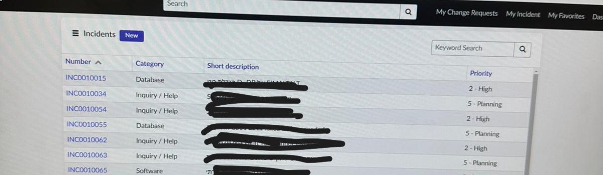

I am using the ServiceNow standard "simple list" widget to display tickets for incidents I have opened.
In esc portal.
Where can I change to change the order of the fields in the list?
thank, Shir

Since you are referring to incident table, you can update the "Mobile" View
If you update the fields in this list view then it will reflect in portal list

For some reason this doesn't work for me, I'm doing it according to the portal view.
The link you sent didn't answer my question either.
Where should I press?
