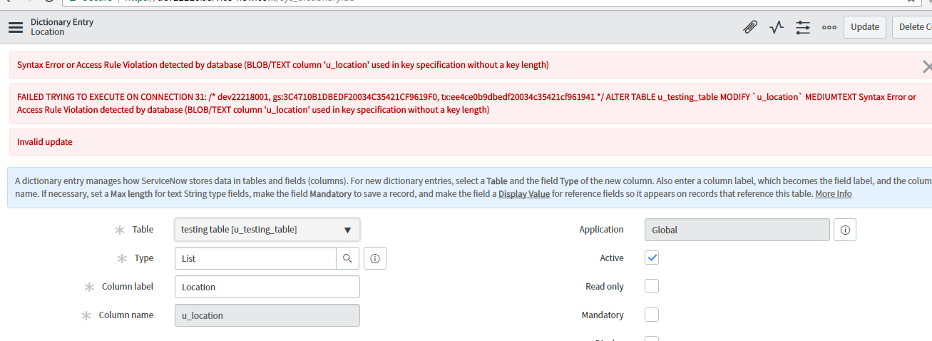

Thanks for your response,
In my developer instance I have 900 records for Resource plan table, So instead to deleting that data, I have tested in another table "testing table". Location field in that table has no data, though when I am changing the type of the field from Reference to List, That is towing same king of error. Please check the below screen shot.
