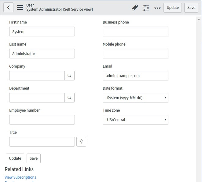

Hi Keith,
This timezone seems to be US/Pacific.
I haven't tried this out earlier. One more thing you can check is with which user the export is running.
Check what timezone is present for that user.
Mark Correct if this solves your issue and also hit Like and Helpful if you find my response worthy based on the impact.
