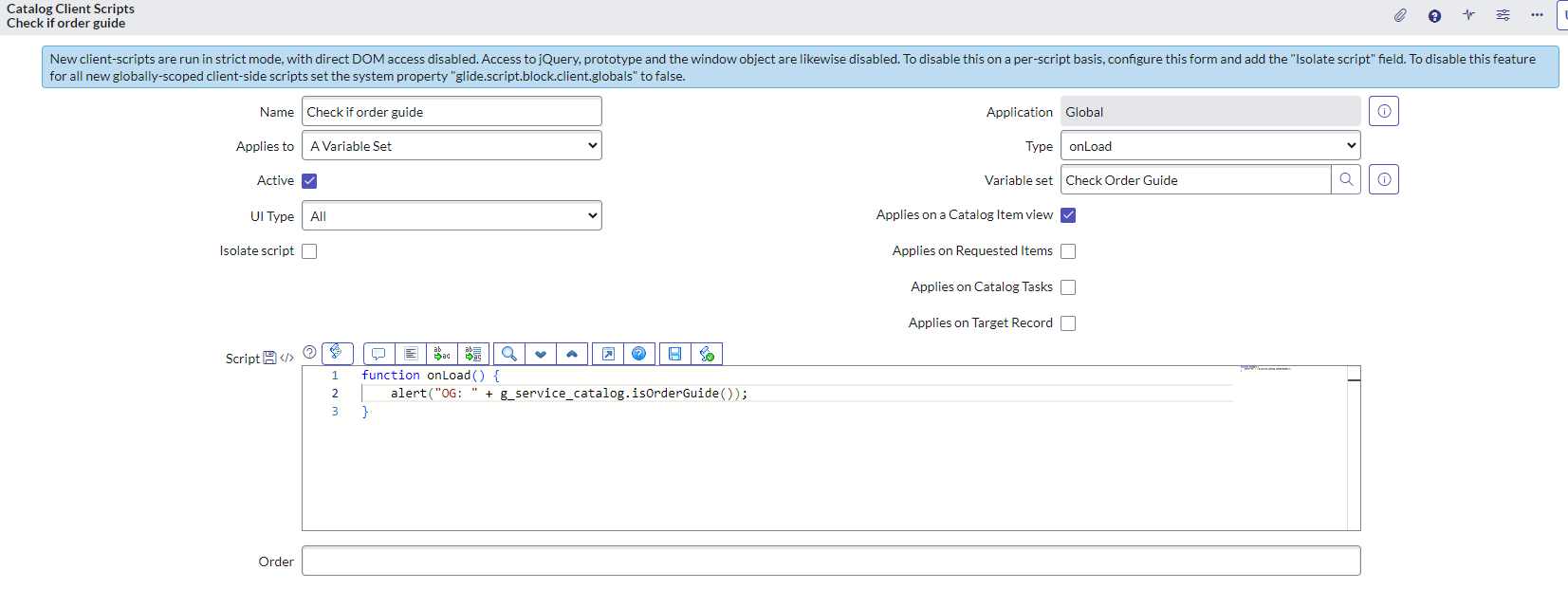

OnLoad Client Script:
function onLoad() {
alert("OG: " + g_service_catalog.isOrderGuide());

01-16-2025 09:46 PM
How exactly did you test that, as it does not work on the actual order guide only the children of that order guide. Because in my testing in the order guide itself, it's returns false.
Another wonder of the SN devs and their coding ability. Imagine removing the table check only to have this nerf'd method.
