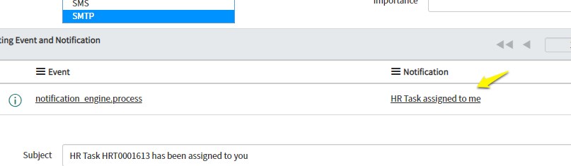

Its very difficult to tell how to check without looking at the instance.
From my side i will check the notification which is receives to the user intially that will be notification.
Navigate to Emails under System Logs and try to filter down with the subject of the email you recieve, once you get the right the email logs then open the record you will notification name as shown below
Open the notification and look at the body contect and see what URL it is passing there you will find where it is navigating either to servicenow or some where else
Please mark helpful / correct based on the impact
