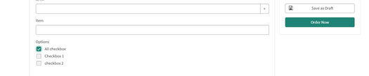

Hi Guys,
I am having an issue I have created few variables with variable type as checkbox(attached screenshot for field deatils) I have multiple field as checkbox type also have a variable name as All it is also checkbox type, so the requirement is when I select All variable then other variable should be unticked and only All varible will be selected and if other variable is selected then All should be unticked.
I have created the UI Policy to clear the value of other variable when All is selected but it is not working when other variable is selected then All is also selected but I don't want All to be selected incase any other variable is selected.

I am not able to view your screenshots due to restrictions but if you haven't used All variable in UI Policy Action, then add UI Policy Action for All and set the opposite value of the other variable to it and try it.

Can you paste the screenshot of the ui policy you have written when value is not all and other variable value is selected.
@abhaysingh98
I think writing the UI Policy only for all should work when value of variable is ALL clear other variable values and under false condition i.e. when value is not all you can clear the ALL checkbox and set it to unchecked.
