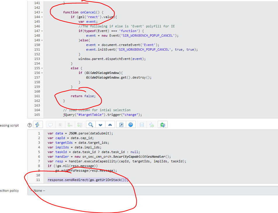

Prana Krushna
GlideModal.get().destroy();
