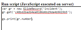

The basic query for incident table for example is:
var gr = new GlideRecord('incident');
gr.addQuery('active', true);
gr.query();
if(gr.next()){
//code here
GlideRecord(''); specifies the table you're querying.
addQuery() allows you to specify conditions. You can select a filter from a list for this as well.
find_real_file.pngabove example could be gr.addQuery('active=true'); as well.
query() runs the query and searches for results.
if(gr.next()) is used to check for a next record and access that if it exists.
You could also use while(gr.next()) but if there are multiple matches for your query then the script inside the while will repeat on all of the matches.

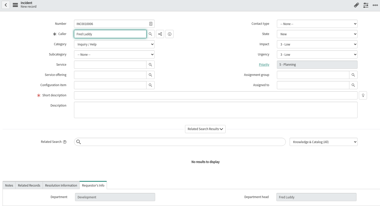

Not a direct answer to your question but if you use the User table which relates to the Department table which has the Department Head you could easily add it to your form with no scripting.
You would dotwalk and just add the field to the form in Form Layout.  Department and Department Head can be accessed by dotwalking from the 'caller' of the record.
