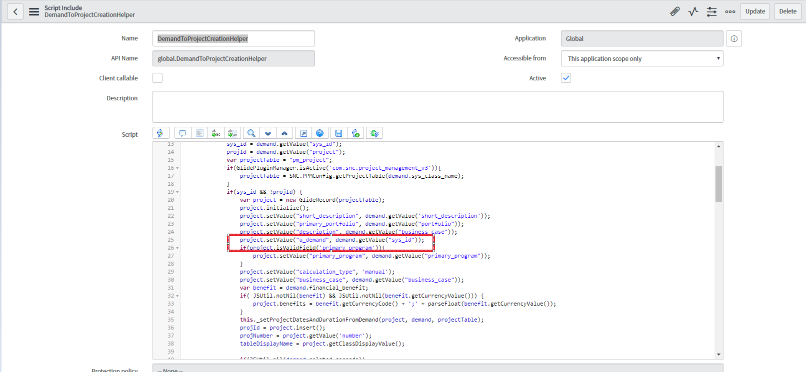

‎07-20-2017 06:16 AM
After reading the Include Script a little closer, I tried something that worked to pull in demand number/link into the project...(added line 6 below) -"u_demand" is the reference field on my project form.
if(sys_id && !projId) {
var project = new GlideRecord(projectTable);
project.initialize();
project.setValue("short_description", demand.getValue('short_description'));
project.setValue("primary_portfolio", demand.getValue("portfolio"));
project.setDisplayValue("u_demand", demand.getDisplayValue("sys_id"));
if(project.isValidField('primary_program')){
project.setValue("primary_program", demand.getValue("primary_program"));
‎07-20-2017 08:29 PM
Yeah that is possible. Create a New Reference Field on the project Table say "Demand" and refer it to the Demand Table. Once the field is created, Update your Script Include as shown below in the screenshot:
Hope this helps.Mark the answer as correct/helpful based on impact.
