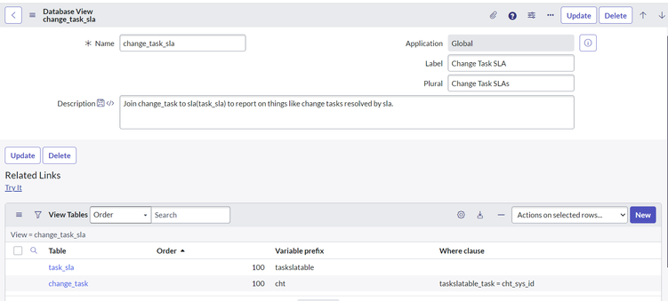

In ur case when u create database view based upon prefix wht u provide it should look something like below
You should write this in where clause of table 2
Lets say prefix u have kept is table1 & table2
Then ur where clause would look like
table1.field2=table2.sys_id

Create the database view with view tables - Table1 and Table 2 and
add a left join with a where clause as - WHERE Table1<var prefix>.field2 = Table2<var prefix>.field1

@Tharun_M Below blog will definitely help you to understand the database view. Also see the video linked in it.
For your case, it is possible to create database view and get all fields of table1 & table2 in single view. You can refer below OOB database view for reference.

According to your description, you state that table1 field2 and table2 field 1 is both string fields but also reference fields - what is correct? If it is reference fields, then you can just dot-walk without the need of a database view. Note that your table1.field2 and table2.field1 is Samsung. I would assume that there are several samsung models, so not the best option to do a database view upon. To create a Database view, you should have a 1-1 or a 1-m relationship between the two tables.
Best regards
Anders
