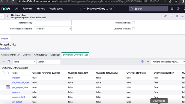

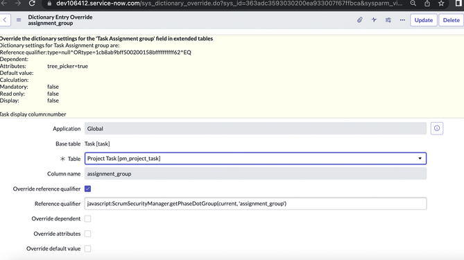

Hey ,
1. Whenever in reference qualifier if you write script first put javascript :  and then write the logic.
2. Kindly check in the dictionary override tab, the table is there or not on which you want this assignment group to to show records. We need to make changes in child table's reference qualifier and leave the parent table field (assignment_group) as it is.
e.g. - below assignment_group is on task table but i want to change reference qualifier on pm_project_task table which is child table of 'task' table.
So, I'll do the change in child table (pm_project_task) of override reference qualifier.
After javascript followed by colon sign , you can write your logic.
Hope this helps!
Kindly mark my responses helpful if it guides you to solutions or help you to understand.
Kartik

Kartik Choudha1
Hey,
You need to achieve this through advance reference qualifier. I believe from advance ref-qualifier this requirement is achievable easily.
User Override Reference qualifier of child table (pm_proejct_task) of parent table (task).
You'll get the pm_project_task table in related tab 'Dictionary Override'.
Correct you filter condition - Condition should be "OR" between type fields
To get you query, you can copy query by right click on breadcrumb(the one you have mentioned in screenshot) . and paste the same reference qualifier.
Note - As you have type condition, you can write if-else as well in reference qualifier.
Let me know about if any help needed in building this query.

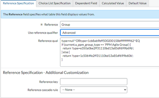

I wrote the if-else query in the Advanced Reference Qual and it didn't show me the groups as expected. It shows me the 'itil' type groups only. Whether I apply the '=' or 'LIKE' operators in the query, it is still giving me the same results.
Hey ,
Hope this helps!
Kartik
Thanks Kartik for your reply.
Thank you for the information regarding the javascript&colon. This is my first time working on something like this. I will keep this in mind.
So I apply the script to the child table, pm_project_task, and the assignment group drop-down showed me the 'itil', 'Agile', and 'PPM Work Center' type. I checked whether I select 'PPM Agile Group' or 'PPM Work Center' option, the drop-down list remain the same. Should the PPM Group Type a reference field to the 'sys_user_group_type' table? Currently, it is a choice.
Here is the result of the drop-down:
Please advised, thank you.
