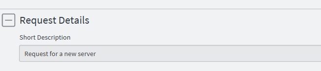

I am new to Service Now and facing issue with the below. Could somebody please help me with this.
Am trying to show the task description on order status page rather than catalog item's description. I went through posts where people could get this done but unfortunately nothing worked for me.
I tried the below steps, but no luck.

This is the description of the catalog item and I need the description of the task created.
