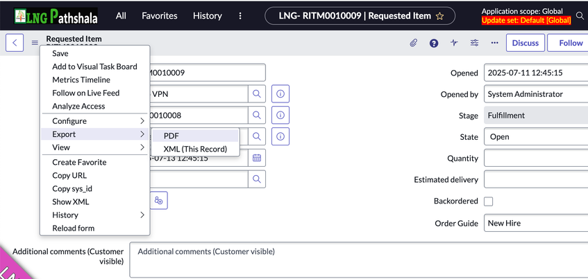

did you try OOTB export
07-21-2025 12:25 AM
yes i tried...
but this OOB export dont include the variable editor
