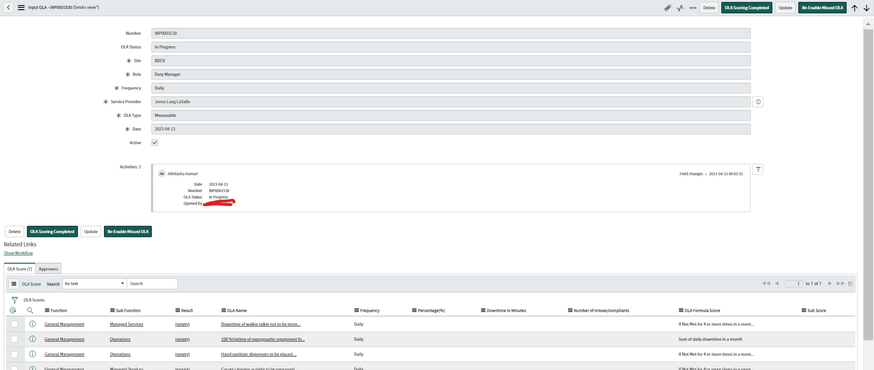

how to fetch value of a related list record and according to that Hide/show the UI action
Pratiksha Lang1
How to fetch value of a related list record and according to that Hide/show the UI action
For example: I have created a relationship between 2 tables. I want to check the related list field - result is empty, If it is empty then the UI action should be visible. otherwise it should not be visible.
UI action created on table - Input ola table
related list - ola score  table
