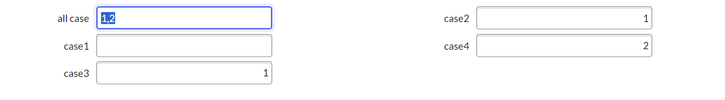

Hi @Anna_Servicenow
Use OnSubmit client script instead of BR and refer following sample script
function onSubmit() {
var allCasesArr = [];
for (i = 1; i <= 10; i++) {
var caseField = "u_caseid_" + i;
var caseVal = g_form.getValue(caseField).toString();
if (caseVal != "" && allCasesArr.indexOf(caseVal) != -1) {
g_form.addErrorMessage("Duplicate Case Entry");
g_form.clearValue(caseField);
} else if (caseVal != "")
allCasesArr.push(caseVal);
g_form.setValue('connect_case_ids_2', allCasesArr.toString());

Tried arrayutils and its not working

@Anna_Servicenow Please update the script as follows and see if it works for you.
 var myArray = [];
    if (current.u_caseid_1 != '' && myArray.indexOf(current.u_caseid_1)==-1) {
        myArray[0] = current.u_caseid_1;
    if (current.u_caseid_2 != '' && myArray.indexOf(current.u_caseid_2)==-1) {
        myArray[1] = current.u_caseid_2;
    if (current.u_caseid_3 != '' && myArray.indexOf(current.u_caseid_3)==-1) {
        myArray[2] = current.u_caseid_3;
    if (current.u_caseid_4 != '' && myArray.indexOf(current.u_caseid_4)==-1) {
        myArray[3] = current.u_caseid_4;
    if (current.u_caseid_5 != '' && myArray.indexOf(current.u_caseid_5)==-1) {
        myArray[4] = current.u_caseid_5;
    if (current.u_caseid_6 != '' && myArray.indexOf(current.u_caseid_6)==-1) {
        myArray[5] = current.u_caseid_6;
    if (current.u_caseid_7 != '' && myArray.indexOf(current.u_caseid_7)==-1) {
        myArray[6] = current.u_caseid_7;
    if (current.u_caseid_8 != '' && myArray.indexOf(current.u_caseid_8)==-1) {
        myArray[7] = current.u_caseid_8;
    if (current.u_caseid_9 != '' && myArray.indexOf(current.u_caseid_9)==-1) {
        myArray[8] = current.u_caseid_9;
    if (current.u_caseid_10 != '' && myArray.indexOf(current.u_caseid_10)==-1) {
        myArray[9] = current.u_caseid_10;
     current.connect_case_ids_2 = myArray.toString();
Hope this helps.

Hi @Anna_Servicenow ,
Try this code working on my PDI
CODE:-
var myArray = [];
    function chkArr(val) {
		if((val != "") && (myArray.indexOf(val) == -1)){
         myArray.push(val);
    chkArr(current.u_caseid_1 .toString());
    chkArr(current.u_caseid_2.toString());
    chkArr(current.u_caseid_3.toString());
    chkArr(current.u_caseid_4.toString());
    chkArr(current.u_caseid_5.toString());
    chkArr(current.u_caseid_6.toString());
    chkArr( current.u_caseid_7.toString());
    chkArr(current.u_caseid_8.toString());
    chkArrcurrent.u_caseid_9.toString());
    chkArr(current.u_caseid_10.toString());
