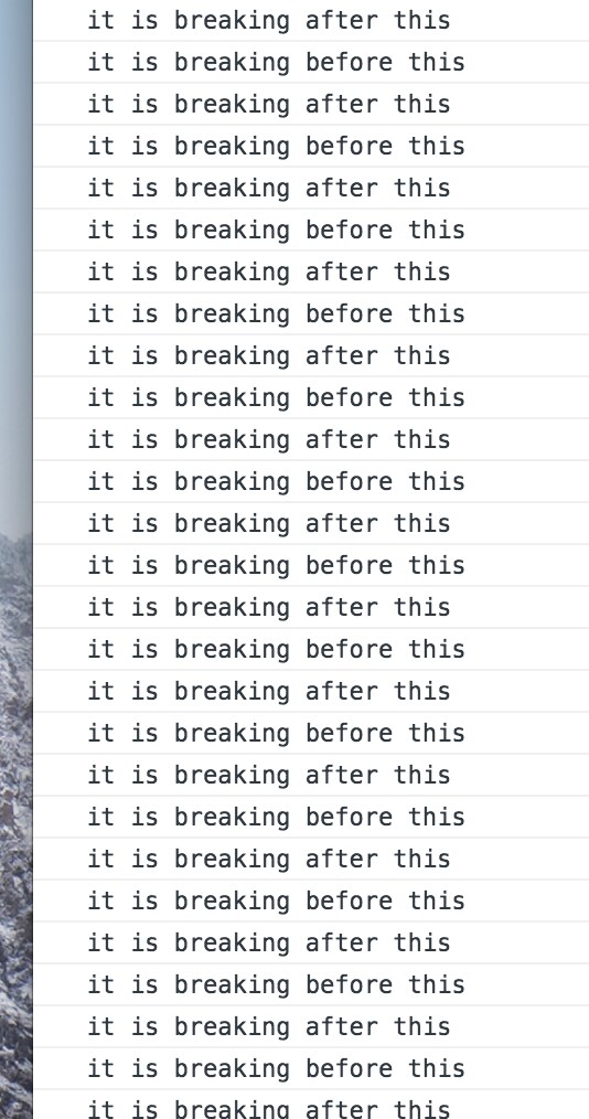

checking back in for help on the "Maximum call stack size exceeded" error I'm getting on a catalog client script.  I've isolated the problem to somewhere between the lines indicated below.  And what it's doing is running this bit of script indefinitely, it's stuck in a loop.  See my screenshot of the console logs. Do you see the error in the script?  Thanks!

upon further investigation, I'm seeing that what's happening is that the line
g_form.setValue('u_currency_amount',putThousandsSeparators(newValue));
is triggering the catalog client script to run again, and that's what causing the loop behavior.  So I need the script to execute, but for it to not trigger the catalog client script to run again when the field gets set...which the system is treating as the field changing again.

thanks for that tip...I actually just figured out that it's not running the function over and over again, it's actually re-running the client script over and over again.  So I just added the bold logic below and now it works.
if (isLoading || newValue === '' || oldValue == newValue) {
return;
