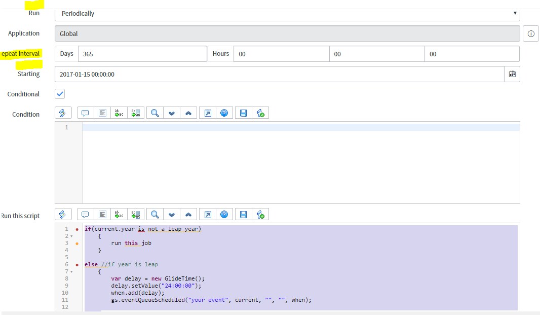

Will this not help you?
run Periodically , after every 365 days. Starting Jan 15

The problem with using a 'Periodic' scheduled job every 365 days is that it is not guaranteed to fire on the 15th February, if 366 days have passed instead due to it being a leap year.
The way that I'd tackle this is with a monthly job on the 15th of the month and a conditional value. Like this....
