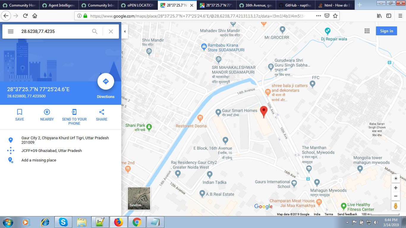

‎03-14-2019 06:14 AM
you can try to call the ui action( system classic mobile UI >> UI Action - Classic mobile ) here that will redirect you to the google map page.
example: i tried to get the caller id location latitude and longitude and then whenever user will click on the ui action it will open the google map page .
Mobile view
Script:
var lat = current.caller_id.location.latitude;
var lon = current.caller_id.location.longitude;
var url = 'https://www.google.com/maps/?q='+lat+','+lon;
action.setRedirectURL(url);
