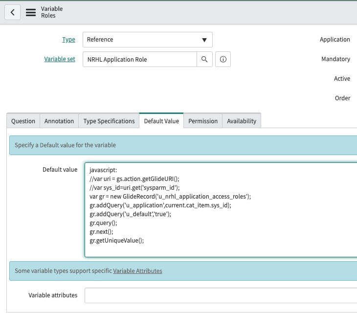

eddie_chang
Giga Contributor
above: Default Value for the variable
application access roles table which contains cat items
I want the Inventory to show as default value when load the item since default flag is set on Inventory.
I found a way to get sys_id of the cat item, but not working in service portal
var uri = gs.action.getGlideURI();
var sys_id=uri.get('sysparm_id');
