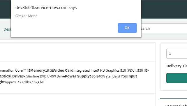

Hi Mark,
Silly one but just for information, can we see if there is any display value for that table, because i was able to get the display value with g_form.getDisplayValue.Check the below ss for the same :-
SS of the alert : -
Omkar Mone.

Hi Mark,
SS of the alert : -
Omkar Mone.
AAAHHHHH it's something on our development instance. Just tested the same on PDI, also Madrid, works fine with getDisplayValue as you mentioned. Now also tested on our test instance, no issues...
I will dig into what might be different/wrong with our development instance.
Tnx.
