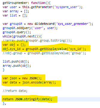

Hi Guys
So I wrote a code to go to sys_groupmember table and get back the groups a user is a member of as an array, to then do an itteration to get the groups and check if the user is a member of a particular group by matching their sys_ids.
I get an issue where If I do method 1 (below):
1. Create object then bring back array of objects
then client side get that array and use evalJason to get the object and iterate through to separate the values that I can use:
This method works in Application for the Cat Item but in Portal causes an 'Unhandled exception in GlideAjax' error.
Reading around the community, I tried Option 2:
2. Turn Object into string and then doing iteration:
Server Side: using stringify to convert array to string
Client Side: parse the array itterate and use the resulting Object:
This version of the code gets me the Object and doesn't cause any JavaScript errors, but the resulting value comes back as 'undefined'
Although in the Alerts, I always get back values using either method before my iteration:
For me method 1 at least brings me back the value, but to work on Portal I need to use stringy.
So in Summary what I need to know is after I stringify the array in the Server script include, I pass it to the Client script, how do I get the singular value from the iteration that doesn't just return 'undefined'.
Kind Regards
Markell
Ankur Bawiskar
for the 2nd approach
1) you can just return the stringified version of string
just use this
return JSON.stringify(array);
Also you require to push the groups then you should be using this
obj.sys_id = groupGr.getValue('group');
Ankur Bawiskar
just use this
Both peices of advice guided me to what I needed. You are a saint and a scholar good sir.
Glad to help.
