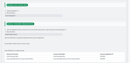

I'm developing catalogue item to create records in our custom table 'u_m2m_depts_config_items'. So it's records that consist of a business application and a department record. I'm using a multi row variable set in my catalogue item to collect the list of consumers:

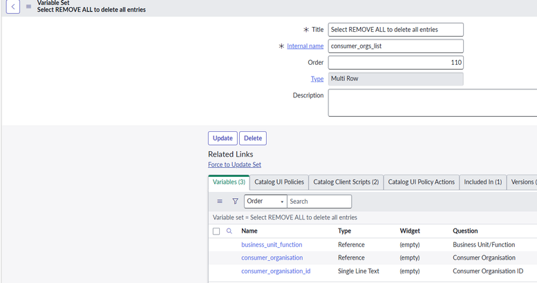

This is my multi row variable set in the back end of ServiceNow:

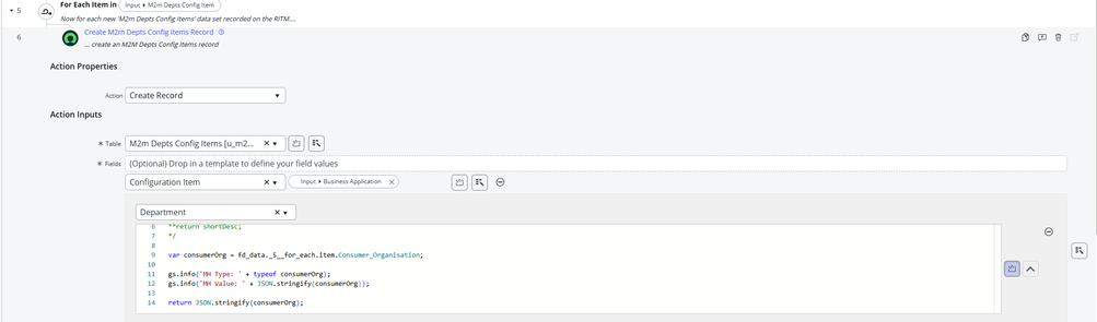

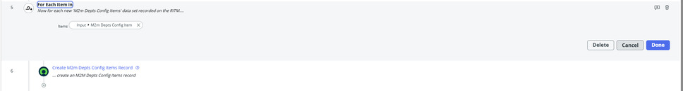

What I'm struggling with is getting the value of the consumer_organisation for each row in my Multi Row Variable Set. I'm trying to implement the below step in my flow:

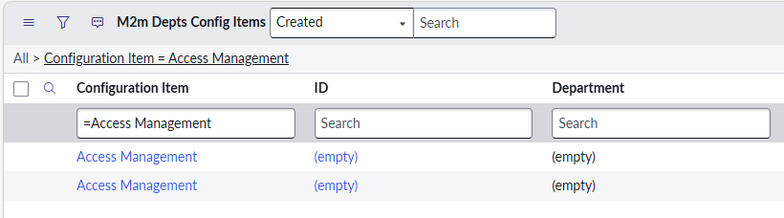

At the moment, when new records in our custom table 'u_m2m_depts_config_items' get created, the following is happening:
Records created:

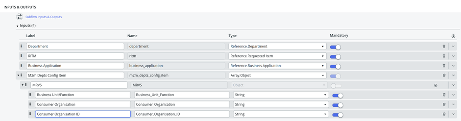

I highly suspect it's because the MRVS object is not compatible with Flow Designers concept of an Object. I frequently run into issues like these.
The answer is almost always going to be that you need to create a custom scripted flow action which will:
1) Take your RITM as an input
2) Output the Array.Object that you need to iterate through to create your m2m records in the latter part of the Flow
