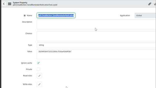

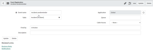

08-12-2023 10:16 AM
@Moin Kazi , yes I created a Event and added that in email notification also.
In Script inlude i written like this,
showRemindersButton: function(sysId) {
var gr = new GlideRecord('sys_email_log');
gr.addEncodedQuery('sys_created_on>javascript:gs.beginningOfLast2Hours()^notification=' + gs.getProperty('pdi.EmailAction.SendReminderNoticationTest.sysId') + '^email.instance=' + sysId);
gr.query();
if (gr.next()) {
return false;
return true;
created system property like this.
Could you please check and correct me if i'm wrong, because it's not working.
