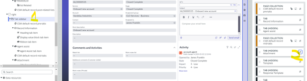

We now go to the tabs to find the attachment tab :

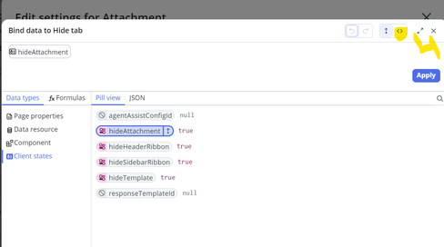

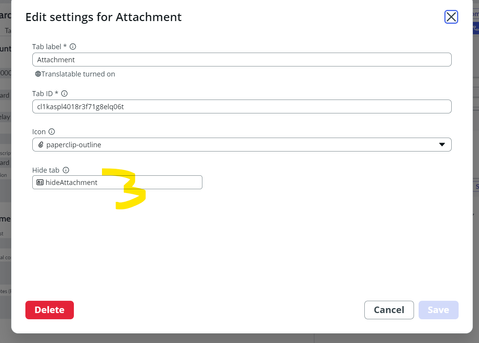

If you click on the tabs component (1) and then click on the tab option (2), you will see the option to show or hide the tab (#3), which by default uses a client state value that is modified by some other data resources.
If you click on this hide tab option, you see the following :
Click on the script option, and use the following code, make sure you use your data resource variable name

function evaluateProperty({api, helpers}) {
  // Get the state value
  var stateValue = api.data.look_up_multiple_records_1.results[0].state.value;
  // if closed return true to hide
  if (stateValue === "3"){
    return true;
// else use with OOB config
  return api.state.hideAttachment;
This was tested in Xanadu, should work in other versions as well.
