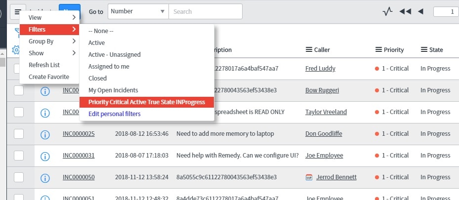

I am not clear about your requirement. But I guess you are trying to make a custom filter.
If you want to combine multiple conditions and create one filter, follow the below steps.
Ex, you want to find some incidents with:
'Priority is Critical', 'Active is True', 'State is In Progress'
Now, you can easily get the all conditions in one. You can see the below incidents.
Please mark Correct/Helpful. It it fulfill your requirement.
