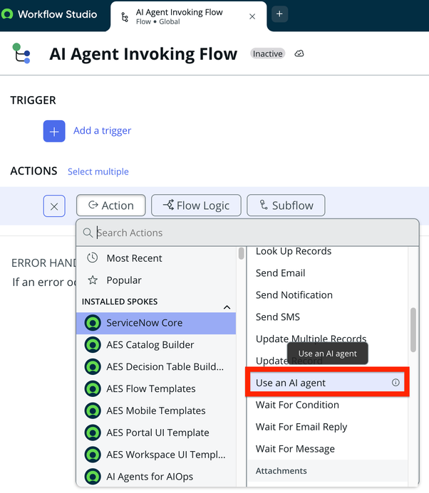

The easiest way today would be to leverage the "Use an AI agent" Flow Action:

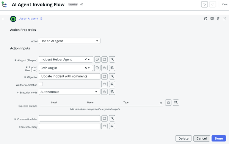

You can fill in the Flow Action values as needed. I recommend testing a few combinations of utterances to verify that the result matches expectations:
Create the Flow Action in the Subflow. Save and Publish the Subflow. Then in your primary AI agent, create a Tool type of Subflow, referencing the Subflow just created.
