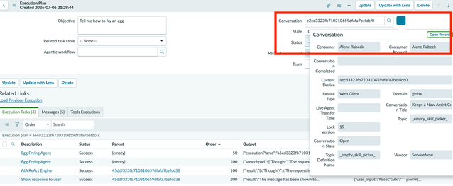

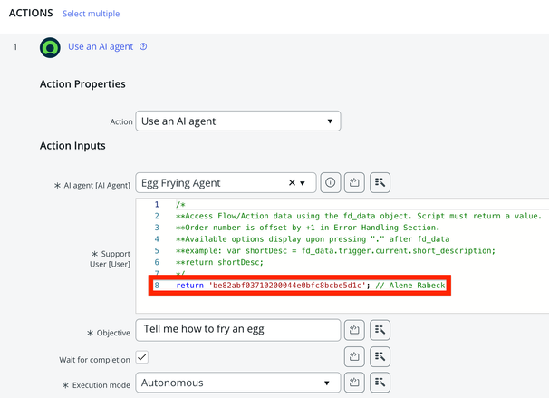

Hi @lukes_19 , apologies for the delay. I was having some issues with getting a proper working instance. I still have the wider team looking at the supervised vs. autonomous configuration, and what kind of outputs we actually expect.
In any case, scripting a User ID into the Subflow should work. I hardcoded the sys_id to return for demo data user Alene Rabeck. Her user record does have the role access required to invoke the AI agent in question (Egg Frying Agent).
In the Subflow:

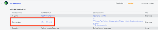

In the Flow Designer Subflow test:
In the AI Agent Execution Plan:
