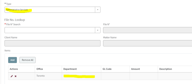

i created this script to push the Type into the MRV but it shows a blank value in the MRV reference variable
      return;
   var type = g_form.getValue('type');
  var obj = (g_form.getValue('items_mrv')) ? JSON.parse(g_form.getValue(items_mrv)):[];
obj.push({department_vc: type});
g_form.setValue('items_mrv', JSON.stringify(obj));

i was able to get it to work by changing the Type variable to a reference but now the GL code Ref. Q. doesnt seem to work
