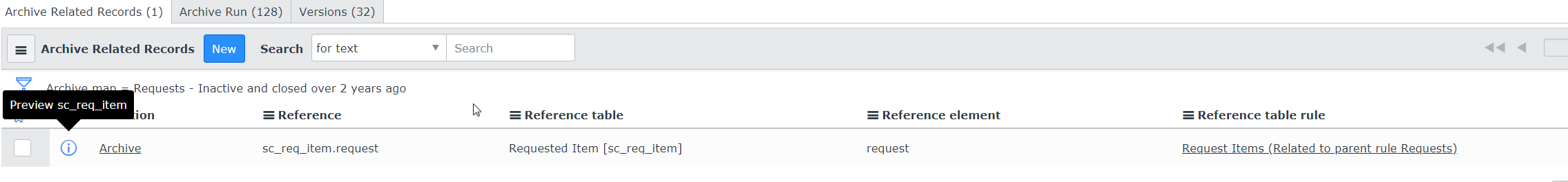

‎04-07-2020 08:22 AM
I have been able to archive sc_request records and also related sc_req_item, sc_task, sc_item_option_mtom records. I am having issues figuring out the best way to also archive the sc_item_option records however without creating a totally separate rule. Where you able to find a solution for the sc_item_option records?
‎04-21-2020 04:02 PM
Geoff,
While on the Requested Item archive rule, go to the "archive related records" related list and click NEW. Then select action=archive and reference=request item... SUBMIT.
Now check the "archive related records" related list and you will see a new entry with reference="sc_item_option_mtom.request_item.mtom" and reference table="Variable Ownership [sc_item_option_mtom]".
Hope this helps.
