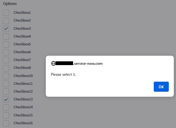

Hello all! I am newer to the scripting side of ServiceNow and I am making a form for users that has 16 checkbox variables available when the user selects a certain answer on a select box in an earlier portion of the form, but I need it so that users must select 3, but can not select more than that. The script I have below will pop up the message and will not allow the form to be submitted when more or less than 3 are submitted, but the issue is it will do the same with 3 submitted as well. How can I fix this? Thank you so much in advance!
function onSubmit(){
//Set the mandatory checkbox variable names and total mandatory count here
var mandatoryVars = 'checkbox1,checkbox2,checkbox3,checkbox4,checkbox5,checkbox6,checkbox7,checkbox8,checkbox9,checkbox10,checkbox11,checkbox12,checkbox13,checkbox14,checkbox15,checkbox16';
var mandatoryCount = 3;
var maxCount = 3;
var passed = forceMandatoryCheckboxes(mandatoryVars, mandatoryCount);
if(!passed){
//Abort the submit
alert('Please select ' + '3.');
return false;
function forceMandatoryCheckboxes(mandatory, count){
//Split the mandatory variable names into an array
mandatory = mandatory.split(',');
var answer = false;
var varFound = false;
var numTrueMan = 3;
var numTrueMax = 3;
var x = 3;
//Check each variable in the array
while(mandatory[x]){
// alert('starting mandatory loop with mandatory being ' + mandatory[x]);
if(g_form.getControl(mandatory[x])){
if(g_form.getValue(mandatory[x]) == 'true'){
numTrueMax ++;
numTrueMan ++;
x++;
else{
x++;
if(numTrueMax < 4 && numTrueMan > 2){
answer = true;
else{
answer = false;
return answer;
Hitoshi Ozawa
Hi Morgan,
Try the following script.
function onSubmit() {
    var maxCount = 3;
    if (!passed) {
        //Abort the submit
        return false;
    function forceMandatoryCheckboxes(mandatory, count) {
        var cnt = 0;
        for (var i = 0; i < mandatory.length; i++) {
            if (g_form.getValue(mandatory[i]) == 'true') {
                cnt++;
                if (cnt > count) {
                    return false;
        return (cnt == count);
Execution:
case 1: nothing checked
case 2: 2 checked
case 3: 5 checked
case 4: 3 checked. Form processed.

Thank you so much Hitoshi! This fixed my issue.
