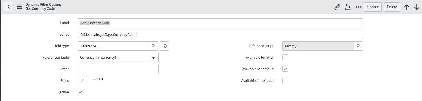

Hi Stephen,
You need to create your own Dynamic Filter on the field you want.
Create a dynamic filter option
You can create for all the reference fields you have on your table and then it woul start showing in your filter. Following is an example for the Currency table. With this, wherever Currency is used a Reference Field, you would get this dynamic filter.
You can find all the Dynamic filters here - https://instancename.service-now.com/sys_filter_option_dynamic_list.do
Hope this helps. Mark the answer as correct/helpful based on impact.
Antin
