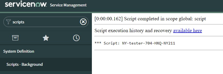

I used this json and it worked well
there should not be a comma after this
"field12332": {
"profile": "xyzrt",
"id": 6,
"value": "NY-tester-704-HXQ-NY211"
var json = '{"field12332":{"profile":"xyzrt","id":6,"value":"NY-tester-704-HXQ-NY211"}}';
var parser = JSON.parse(json);
var value = parser.field12332.value;
gs.info(value);
Output:
