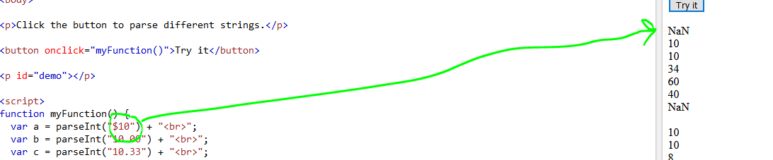

Yep, tried that. Still no worky.
This is from w3 schools example
you have to remove the $ amount ,
