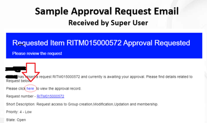

I have this task , When I click on 'here' from below notification then It should redirect me to related approval record. The below notification is triggered when record is inserted in RITM table. Please check the image attached.
PS. I have tried ${sysapproval.URI_REF} but it is redirecting to current RITM record.

Hi @MH3 ,
Try these if there is a reference field for sysapprover table in the RITM.
${sysapproval.URI}
If there is no reference field, then you need to do it via email script.

Hi @MH3
var approvalRecord = " ";
var gr = new GlideRecord("sysapproval_approver");
gr.addQuery("document_id",current.getUniqueValue());
gr.query();
if(gr.next()){
approvalRecord = gr.getUniqueValue
template.print('<a href='+gs.getProperty('glide.servlet.uri')+'sysapproval_approver.do?sys_id='
+ approvalRecord + '>' + "here "+ '</a>');
//if the property doesn't work check if there is property in your instance then only it will work

Your notification is on RITM table and there is no any referenced field that is referring to sysapproval_approver table that's why it's not showing the approval record after clicking on link.
You need to write email script for this.
