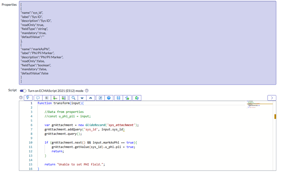

06-02-2026 02:27 PM
Would love some deeper explanation on the event mapping and server action!
So far I believe I've gotten the event mapping correct.
I did step 1.
For step 2 I set it so when the "Attachment upload succeeded" event executes, it will run my custom Transform data resource conditionally, only if "markAsPhi" is true.
Step 3 is where I'm having issues now. I'm a bit confused as to how to setup the Transform Data Broker Server Script. I have it marked to "Mutate server data", and I created an ACL with the sysid of my new script for an execute for a ux_data_broker. I'm just not sure how to use the input correctly. I believe my script/properties aren't correct which is causing my event handler to be incorrect.
