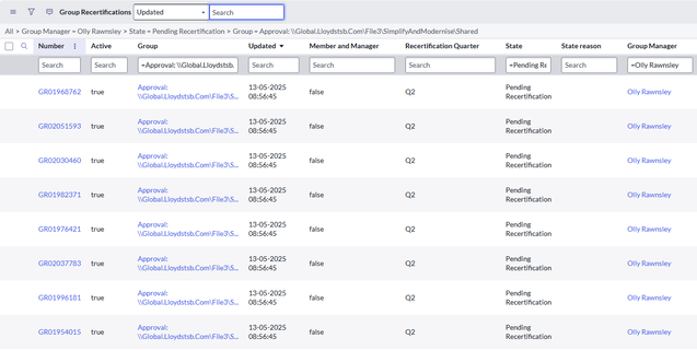

I'm working on a situation where the 'Group Manager' within a table of records will change. In the below screenshot, the same group can be assigned to multiple records and sometimes, the Group Manager will change

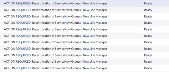

However what I'm finding is that when I change the Group Manager in a group, it will generate the same email multiple times to the new manager:
So I was just wondering if there was a way of sending the email only once rather than multiple times when the Group Manager changes.
05-14-2025 03:45 AM
since you are updating those many records and manager is changing for each of those, it's sending those many emails
