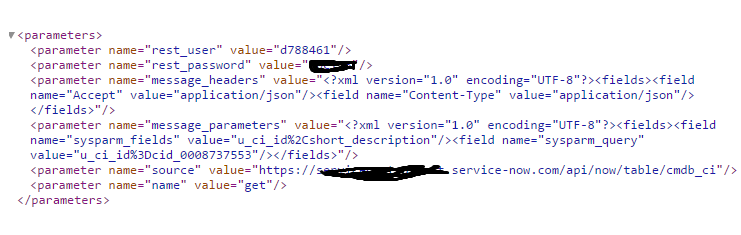

I have created REST Outbound Message. I am able to recieve response in JSON format, but I want to send the outbound request in JSONformat.
Please suggest.
Response:
Request:
