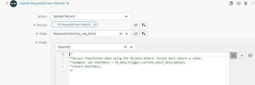

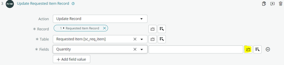

Toggle to Scripting
Click on the Highlighted icon to toggle to script.
This Script box appears where you can write the code.

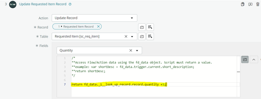

Write below script -
return fd_data._1__look_up_record.record.quantity +1;
And about how to populate fd_data.
You can simply write fd_data. and press ctrl+spacebar to get the datapills. It is ame like drag and drop of data pills but through script - Using script you can manipulate the data, In your case we are taking Quantity and increase it by 1.

You can use write script to read the integer data and add 1 to it in field mapping script.
Below is example I did in PDI for knowledge view count update:
You need to select your update record step after fd_data. in above script.
Hope this helps.
Ali

Hello @Aki18
Just open the script editor in field map using the icon pointed in my last answer, the script editor, when you type "fd_data." , you will automatically get suggestions for available data points in the flow.
Let me know for any issue.
