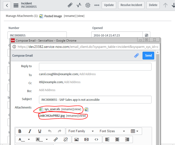

In Geneva, in and incident form, select the 3 circle toggle button on the header and select E-mail. Attach any file and send the email. The Email activity is shown in the activity list of the corresponding incident form and also the email is attched as attachment to the incident form. But there is a requirement to attach those attachment from the email to the incident form and show the attachments in the activity list of the corresponding incident form when the email is sent.
Can anyone please suggest how it is possible?
I want these above attachments to be shown in the activity list of the incident INC0000055.

What do you mean by showing attachment ? An entry to state the attachment or show the content of the attachment itself?
11-25-2016 05:54 AM
Hi Kalaiarasan,
I just want to display the attachments as the attachments attached to incident record displayed in the Activity .
As example , for image file it will be displayed as below
For zip file it will be displayed as
Besically, if we can attach those attachments somehow to the originan incident record it will do the trick.
11-25-2016 06:03 AM
I guess you will need to find a way to attach the files of the mail to the ticket itself. Then it could work.
