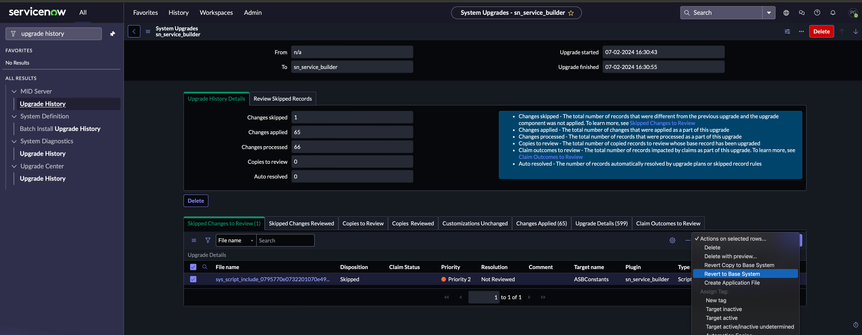

You should be able to manage these skipped records the in the same way as you'd manage them for an upgrade.
Navigate to Upgrade Center > Upgrade History, change the 'History Type' filter from 'Upgrade' (e.g., to Plugin, Application, Update Set, etc.) and look for the entries you need showing 'Changes skipped'. Then open the records and look at the related lists to revert skipped records to base system.
Here's an example screenshot showing a customised record (in this case a ServiceNow provided patch to a script include from the Service Builder plugin) about to be reverted to the base system.
