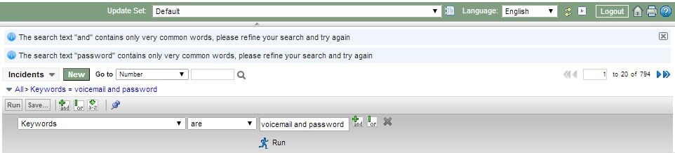

‎03-21-2014 12:46 PM
Hi mark.stanger
I am trying to search all fields including the activity log so I went to All Incidents then filtered to Keywords and put in voicemail and password, I received the two informational messages:
"The search text "and" contains only very common words, please refine your search and try again"
"The search text "password" contains only very common words, please refine your search and try again"
How do I get a listing of what the common words are and any idea on how to eliminate these messages"?
