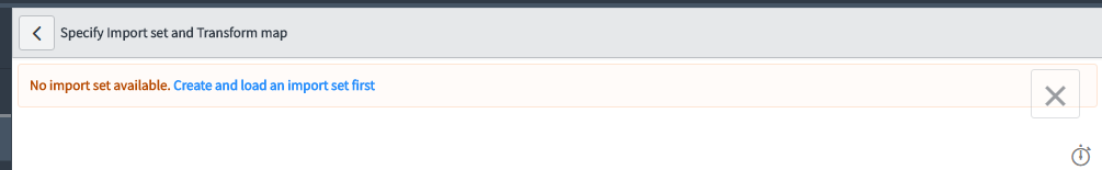

1. I have created rest message and calling rest message from scheduled job, when it get executed data will be stored in import set table.... and i had created transform map also, and mapped the import set table and target table.... But when i click on transform, it is not happening... How to run transform?

swathigangadhar
Yes, i have done mapping between two tables, when i press transform am getting the above error....
