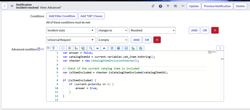

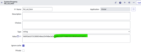

Subhashis Ratna
Hi @avinashdube
I have updated and retested your code, and it's fine. So, you need to pass the sys_id of the record like this.
Demo Sys_Property :
Updated code :
Script include Code :
isCatalogItemIncluded: function(currentsysID) {
    var listOfCatalogItems = gs.getProperty('NotificationImprovement_ListofCatlogItemtoInclude');
    if (listOfCatalogItems && listOfCatalogItems.includes(currentsysID)) {
        return true;
    return false;
Based on the return value, you can use this code in a notification script like this :-
var answer = false;
var catalogItemId = current.variables.cat_item.toString();
var checker = new CatalogItemInclusionChecker();
var isItemIncluded = checker.isCatalogItemIncluded(catalogItemId);
if (isItemIncluded) {
    if (current.priority == 1) {
        answer = true;
If this solution resolves your query, kindly mark it as the accepted solution and give it a thumbs up.

Hi @avinashdube
Demo Sys_Property :
Updated code :
        return true;
    return false;
var answer = false;
        answer = true;
Subhashis Ratna
