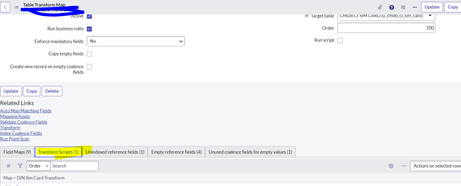

I have a requirement where I need to update the network type of different CI classes.
I have a transform map running on cmdb_ci table but I dont find network type in cmdb_ci table but I see it in cmdb_ci_netgear.
How to I use the transform map and update the same?

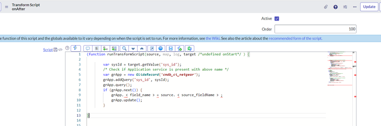

09-14-2023 07:32 AM
You can use onAfter Transform script
onAfter script :
(function runTransformScript(source, map, log, target /*undefined onStart*/ ) {
// will get the sys_id of just created target record. assuming you are mapping "class"
var sysId = target.getValue('sys_id');
var grApp = new GlideRecord('cmdb_ci_netgear');
grApp.addQuery('sys_id', sysId);
grApp.query();
if (grApp.next()) {
grApp. < field_name > = source. < source_fieldName > ;
grApp.update();
ServiceNow Developer
- Socrates
