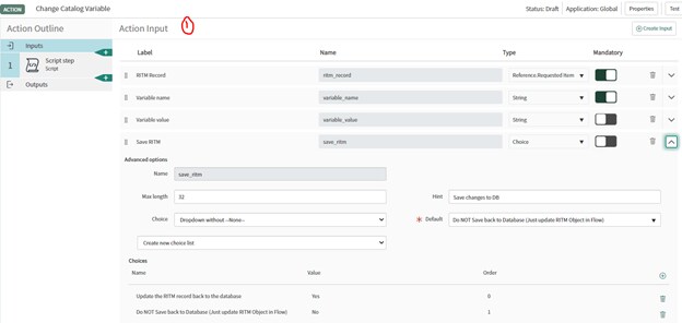

I created a NEW "Flow Action" in Flow Designer with the following configuration (see screenshots below):
Action Inputs
The Action Inputs are the parameters, that your Action accepts to control what happens:
a) RITM Record : Will be the reference to the RITM with the variables to update (usually from the trigger record)
b) Variable name: Filled with the NAME of the Varibale, that you want to be updated
c) Variable value: The NEW Value, that you want to write to your Variable
d) a choice field to select, if you want to SAVE the current RITH record back to the Database, or just want to change the variable value. (Note: SAVING will not only save the ONE Variable, but ALL changes of the RITM Record!!!!). In a variant of this Action, it could be made possible to update ONLY the variable, by NOT updating the RITM table, but by updating the table, where the variables are stored...
The next screenshot shows the choices for the option to SAVE or not to SAVE.

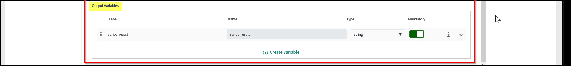

The Action Output
