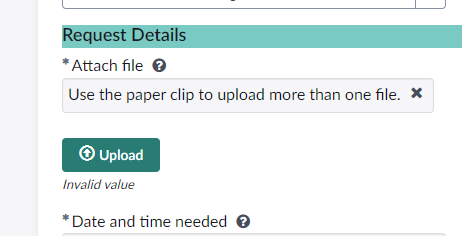

Thank you for sharing your solution. unfortunately it is not working for me. First, why is the record query step needed? just to be sure we are grabbing the correct id? and second, I am using this in a record producer but when I set the value the screen shows 'invalid value' even thought the record query step successfully found the attachment. Any ideas on why it is not working for me?

We faced the same issue. For us it was a permission issue. The dummy attachment we uploaded to sys_attachment was against a particular table which the impersonated user in the ATF did not have access to. There's an OOTB ACL that grants read access to sys_attachment records if the table_name field is empty, so we decided to make this blank on the dummy sys_attachment record which allowed things to work. Just keep in mind that this will make the attachment available to all users (if you have explicit roles plugin turned on, it'd make it available to all snc_internal users).
