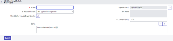

In the UX Client Script Includes table [sys_ux_client_script_include], create a new record.
The form will be looking like this:
You might wonder what is the difference between Name and API Name fields:
- Name = the "display name" of your script
- on the FE side, you will use it to add the SI into a UIB script
- API Name = the "system name" of your script
- on the FE side, you will use it to call the SI in the UIB script
- API Name is read-only field and will auto-populate
- the value consists of two dot-separated parts:
- the first one = your current application scope
- the second one = the value you have put into the Name field
- so, if you are in the global scope and the Name is "exampleSI", the API Name would be: global.exampleSI
However, the most important field is the Script field. You can see a prefilled include function there, looking like this: function include({imports}){}. Here is where all the magic happens. Whatever you put in the empty curly brackets will be executed in your browser after you call the SI.

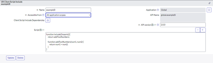

return addTwoNumbers;
function addTwoNumbers(num1, num2) {
return num1 + num2;
As you can see, the core of the SI is still the include function as it was in the previous example. Only now the include function is somewhat more complex: it returns the addTwoNumbers function which, on its part, returns the sum of its two arguments.
The complete definition of our SI could look something like this:
For our purposes, we have allowed this script to be called from any application scope, but you can restrict it to your scope only (using Accessible from field).
