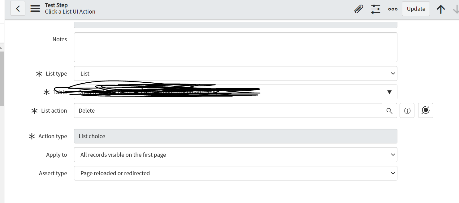

Hi @Ankur Bawiskar
below are the two steps:
So is the step getting failed?
if yes then with what message?
The error message is : "FAILURE: The 'Document Link' list could not be found on the currently open page" hence the next step gets skipped as well.
