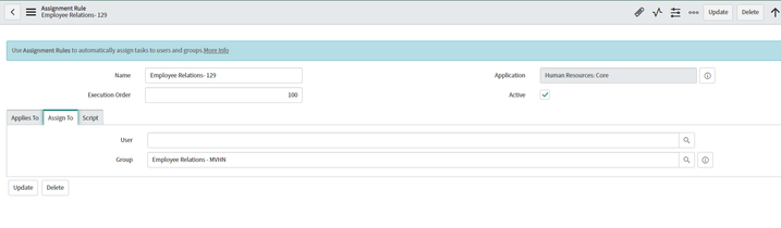

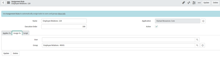

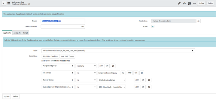

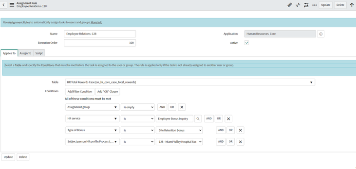

I have 2 identical Assignment rules, one is working and the other is not. I cannot figure out why one of them is not working. I have put the screenshots below. "Employee Relations- 129" is working and "Employee Relations- 128" is not working. There is nothing on the script tab for either one. Any assistance is appreciated.

The COE table is correct and so is the assignment group. It is set up exactly like my other assignment rule that is working. There is no assignment group listed on the HR Template either. This service does not have a record producer so there is nothing there either.
