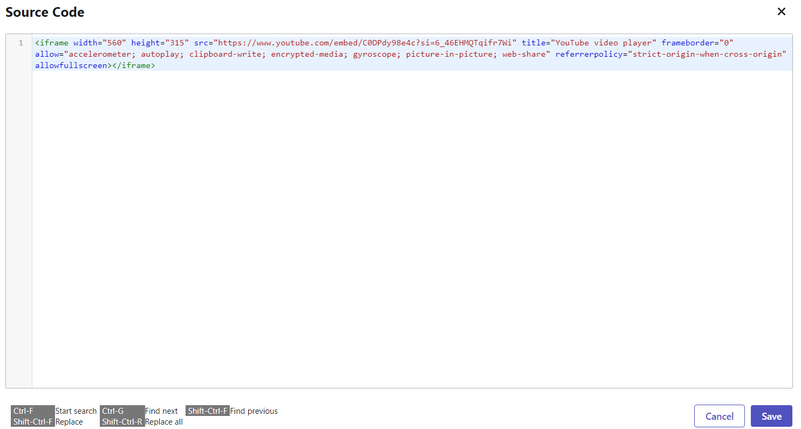

I discovered that the HTML Editor (TinyMCE) is stripping out the referrer-policy HTML attribute. The way I discovered this is embedding a video via Source code in a KB Article.
Take an example from YouTube. Let's pick this test video:
https://www.youtube.com/watch?v=C0DPdy98e4c
Copy the embedded code into KB Article -> HTML Editor -> Source Code:
<iframe width="560" height="315" src="https://www.youtube.com/embed/C0DPdy98e4c?si=6_46EHMQTqifr7Wi" title="YouTube video player" frameborder="0" allow="accelerometer; autoplay; clipboard-write; encrypted-media; gyroscope; picture-in-picture; web-share" referrerpolicy="strict-origin-when-cross-origin" allowfullscreen></iframe>
Click "Save"
Now re-open Source Code. For me, it strips out the refererpolicy HTML attribute:
It doesn't have to be a YouTube video. It could be any type of embedded video. Probably any type of embedded content but that's not confirmed, as most embedded code snippets you'll find are iframes.
